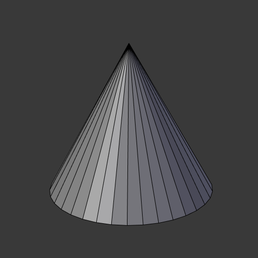

../../../_images/modeling_modifiers_generate_remesh_example-none.png
Unmodified mesh.

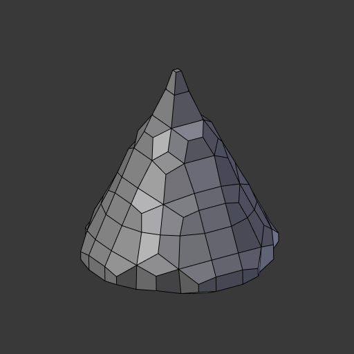

../../../_images/modeling_modifiers_generate_remesh_example-blocks-depth-3.png
Blocks mode with Octree Depth 3.
