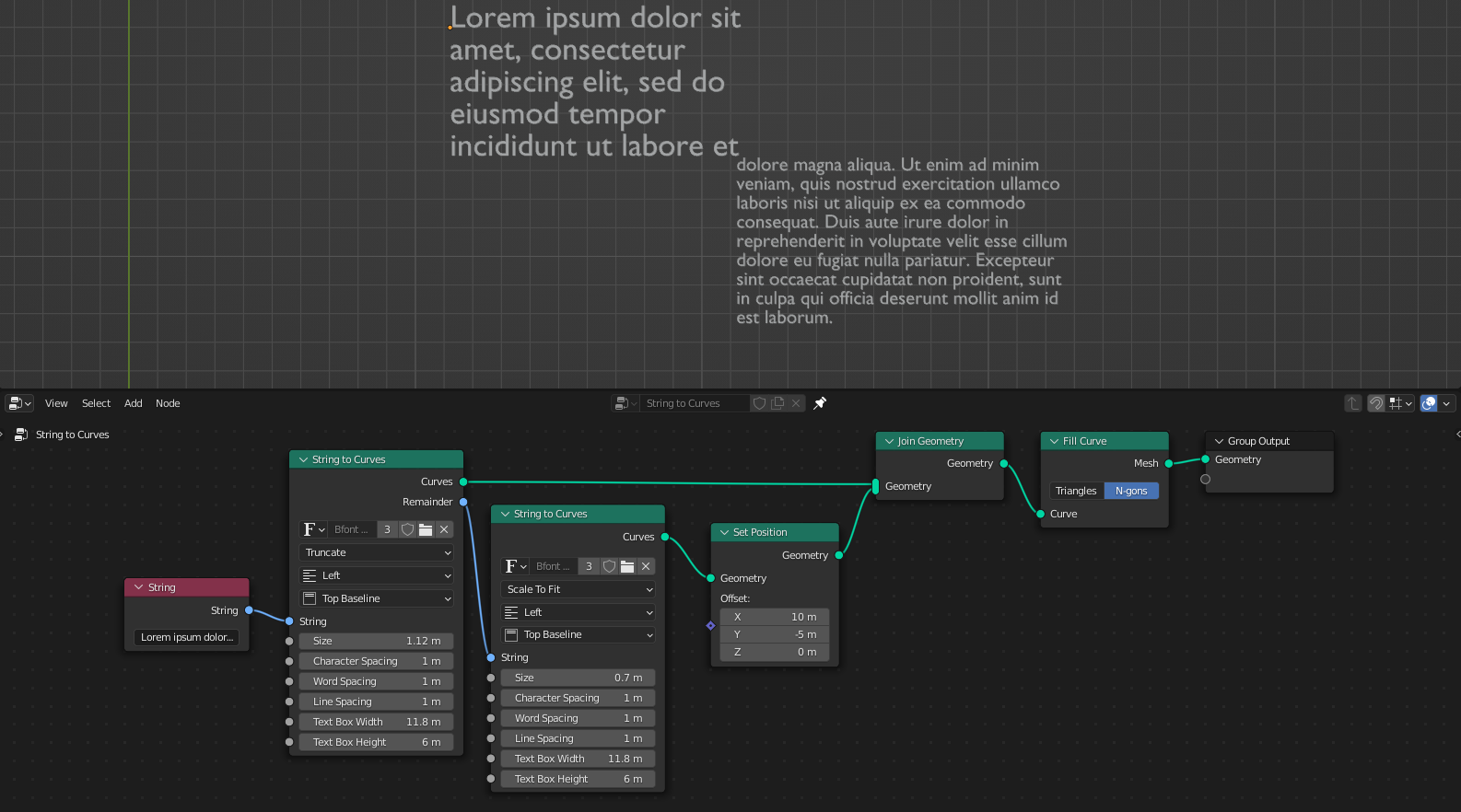

Examples (Voorbeelden)
../../../../_images/modeling_geometry-nodes_text_string-to-curves_example.png
The node can be used to make overflowing text boxes. Here, the text that does not fit into the first node’s fixed-size text box is passed to a separate String to Curves node, then scaled with a Scale to Fit node.
