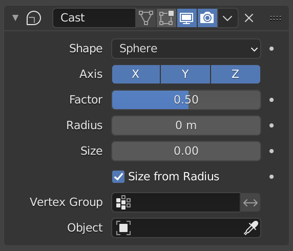

Options (Opties)
../../../_images/modeling_modifiers_deform_cast_panel.png
The Cast modifier.
Shape
Menu to choose target shape of the projection: Sphere, Cylinder or Cuboid.
Axis (As)
Toggle buttons to enable/disable the modifier in the X, Y, Z axes directions (X and Y only for Cylinder cast type, since the Z axis remains unaffected).
Factor (Factor)
The factor to control blending between original and cast vertex positions.
It is a linear interpolation: 0.0 gives original coordinates (i.e. modifier has no effect), 1.0 casts to the target shape.
Values below 0.0 or above 1.0 exaggerate the deformation, sometimes in interesting ways.
Radius
If nonzero, this radius defines a sphere of influence. Vertices outside it are not affected by the modifier.
Size (Grootte)
Alternative size for the projected shape. If zero, it is defined by the initial shape and the control object, if any.
Size from Radius
If activated, calculate Size from Radius, for smoother results.
Vertex Group (Vertex Groep)
If set, restrict the effect to only the vertices in that vertex group. This allows selective, real-time casting, by painting vertex weights.
Invert
Inverts the influence of the selected vertex group, meaning that the group now represents vertices that will not be deformed by the modifier.
Object (Object)
The name of an object to control the effect. The location of this object’s origin defines the center of the projection. Also, its size and rotation transform the projected vertices.
Hint
Animating (keyframing) this control object also animates the modified object’s casting deformation.

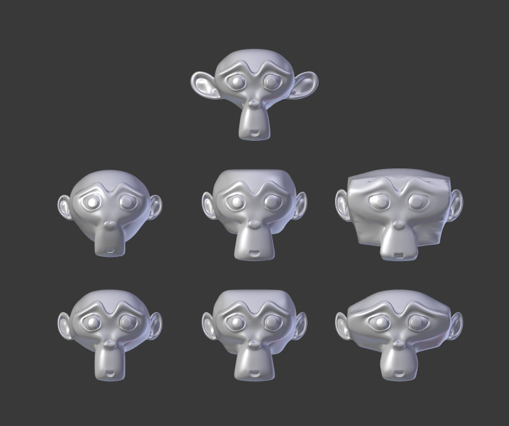

Voorbeeld
../../../_images/modeling_modifiers_deform_cast_example.jpg
Top: Suzanne without modifiers. Middle: Suzanne with each type of Cast Modifier (Sphere, Cylinder and Cuboid). Bottom: Same as above, but now only X axis is enabled. Sample blend-file.
