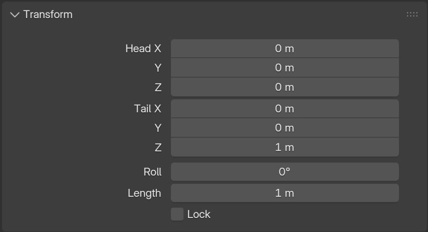

../../../../_images/animation_armatures_bones_properties_transform_panel-edit.png
Het Transform-paneel (Edit Mode).

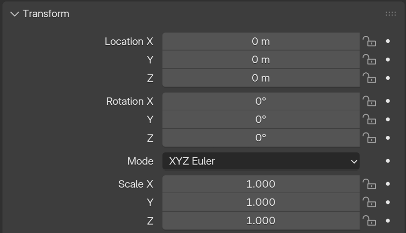

../../../../_images/animation_armatures_bones_properties_transform_panel-pose.png
The Transform panel (Pose Mode).
When in Edit Mode you can use this panel to control position and roll of individual bones. Whereas in Pose Mode you can only set location for the main bone, and you can now set rotation and scale.
In addition, in Pose Mode it is possible to restrict changes in position, rotation and scale by axis on each bone in the armature.
Head X, Y, Z
Location of head end of the bone.
Tail X, Y, Z
Location of tail end of the bone.
Roll (Rol)
Bone rotation around head-tail axis.
Length (Lengte)
The distance from the bone’s head to its tail. Changing the length moves the tail end.
Lock (Vergrendelen)
Bone is not able to be transformed when in Edit Mode.
