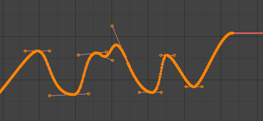

../../../_images/editors_graph-editor_fcurves_editing_sample.png
F-Curve voordat deze gebakken wordt.

../../../_images/editors_graph-editor_fcurves_editing_clean1.png
F-Curve voor verzachting.
../../../_images/editors_graph-editor_fcurves_editing_smooth.png
F-Curve na verzachting.
