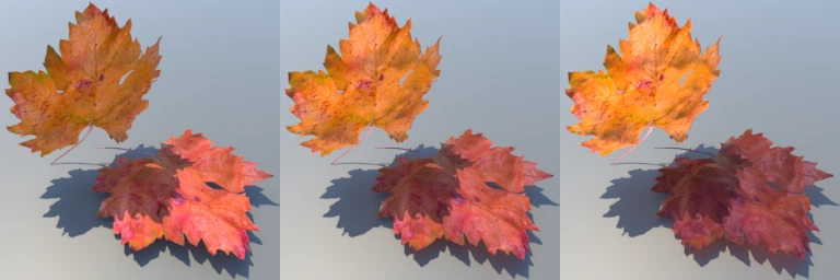

Thin Wall Mode
When the Thin Wall Boolean is enabled, the surface is switched to thin-walled mode. In this mode the surface is a slab with its layers mirrored around the base, and the thickness is assumed to be zero.

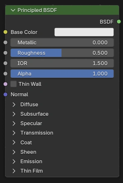

Inputs (Inputs)
Base Color
Overall color of the material used for diffuse, subsurface, metal and transmission.

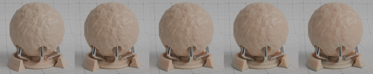

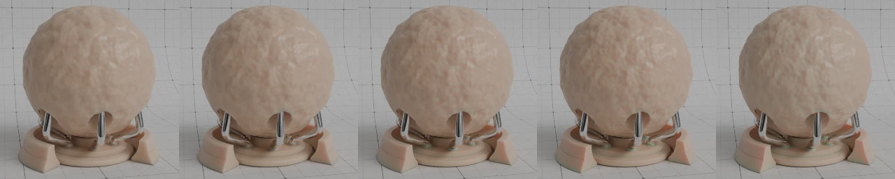

Subsurface
Subsurface scattering is used to render materials such as skin, milk and wax. Light scatters below the surface to create a soft appearance.

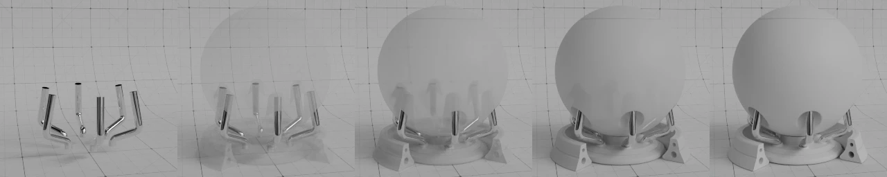

Transmission
Transmission is used to render materials like glass and liquids, where the surface both reflects light and transmits it into the interior of the object

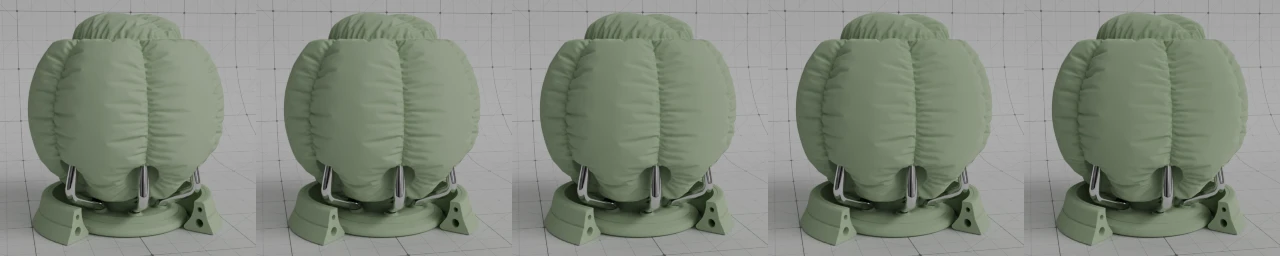

Sheen
Sheen simulates very small fibers on the surface. For cloth this adds a soft velvet like reflection near edges. It can also be used to simulate dust on arbitrary materials.
