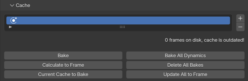

Cache (Opbergplaats)
Reference (Referentie)
Type (Type):
Canvas
Panel (Paneel):
Physics ‣ Dynamic Paint ‣ Cache
../../_images/physics_dynamic-paint_canvas_cache-panel.png
Canvas cache panel.
This panel is currently only visible for Vertex format surfaces. You can use it to adjust and bake point cache.
