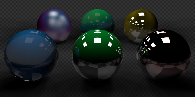

../../../_images/render_cycles_object-settings_object-data_shadow-catcher.jpg
Example of the shadow catcher. Note how the material of the plane can still be viewed in the spheres.

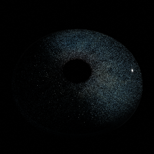

../../../_images/render_cycles_object-settings_caustics-example1.png
Rendering caustics inside an eye without MNEE at 32 samples per pixel.
../../../_images/render_cycles_object-settings_caustics-example2.png
Rendering caustics inside an eye using MNEE at 32 samples per pixel.
