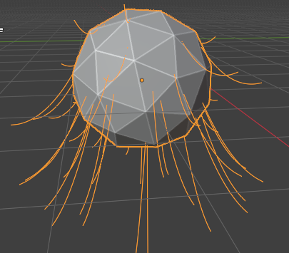

Stretchiness without bendiness
Hair curve simulation with high stretchiness but low bendiness values can lead to un-physical deformations, as if the hair is curling upwards.
../../../_images/modeling_geometry-nodes_simulation_hair-dynamics_shear-example1.png
This is caused by excessive shearing, where positions are allowed to deviate from the forward direction of rotation (blue arrows in the figure below), but rotation remains stiff.
