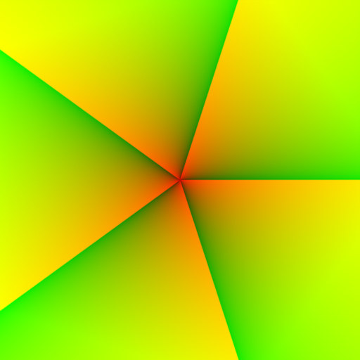

Sides
Number of radial segments to divide the input coordinate system into. A non-integer value results in an irregular segment that is smaller than the regular segments.
../../../../_images/render_shader-nodes_radial_tiling_segments-5_0.png
Sides: 5.0.

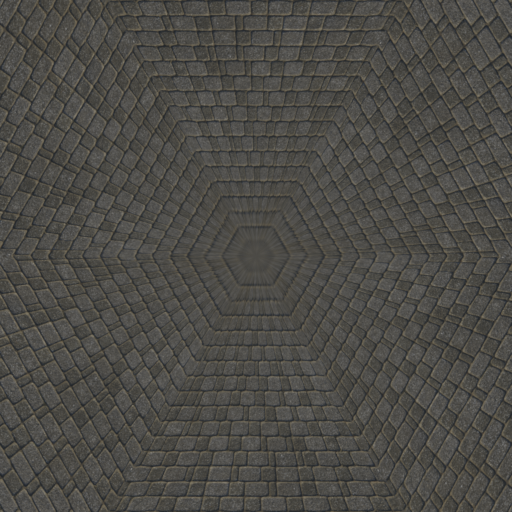

When working with textures that span the entire UV space there is usually the issue of visible seams along segment borders even if the original texture is seamless. The Normalize option eliminates these visible seams by ensuring that the X-coordinates always only cover the entire 0 to 1 range. This also introduces a distortion effect, which depending on whether or not it’s desirable may need to be mitigated using additional nodes.
../../../../_images/render_shader-nodes_radial_tiling_example_normalize-disabled-pavement.png
Normalize: Disabled.
../../../../_images/render_shader-nodes_radial_tiling_example_normalize-enabled-pavement.png
Normalize: Enabled.
