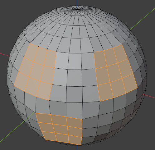

Example
../../../../../_images/modeling_meshes_editing_mesh_transform_flatten_example-1.png
Before.

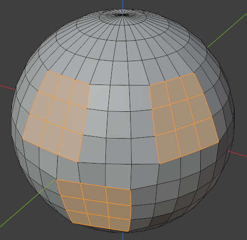

../../../../../_images/modeling_meshes_editing_mesh_transform_flatten_example-2.png
Flattened using Best Fit.

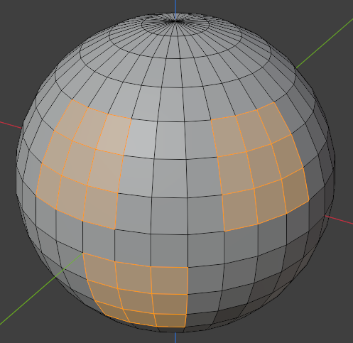

../../../../../_images/modeling_meshes_editing_mesh_transform_flatten_example-3.png
Flattened with axis locking.
