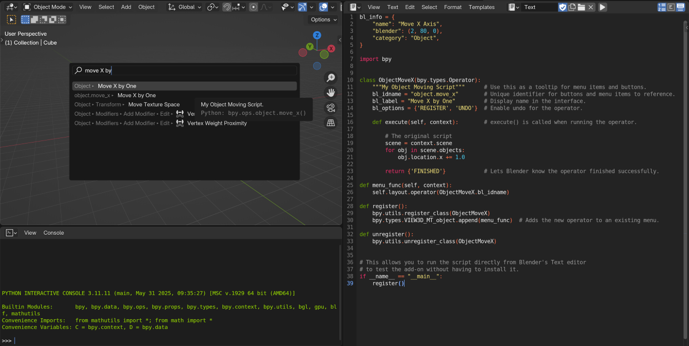

To test the script, you can copy and paste it into Blender's Text editor and run it. This will execute the script directly and call register immediately.
However running the script won't move any objects. For this, you need to execute the newly registered operator.
../../_images/advanced_scripting_addon-tutorial_operator-search-menu.png
Operator Search menu.
Open the Operator Search menu and type in "Move X by One" (the bl_label), then Return.
The objects should move as before.

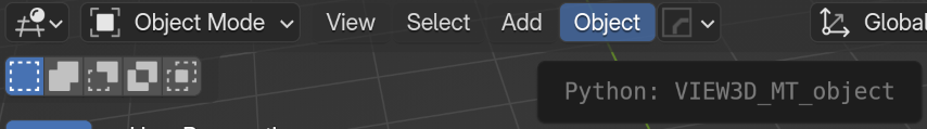

def menu_func(self, context):
    self.layout.operator(ObjectCursorArray.bl_idname)
# store keymaps here to access after registration
addon_keymaps = []
def register():
    bpy.utils.register_class(ObjectCursorArray)
    bpy.types.VIEW3D_MT_object.append(menu_func)
    # handle the keymap
    wm = bpy.context.window_manager
    # Note that in background mode (no GUI available), keyconfigs are not available either,
    # so we have to check this to avoid nasty errors in background case.
    kc = wm.keyconfigs.addon
    if kc:
        km = wm.keyconfigs.addon.keymaps.new(name='Object Mode', space_type='EMPTY')
        kmi = km.keymap_items.new(ObjectCursorArray.bl_idname, 'T', 'PRESS', ctrl=True, shift=True)
        kmi.properties.total = 4
        addon_keymaps.append((km, kmi))
def unregister():
    # Note: when unregistering, it's usually good practice to do it in reverse order you registered.
    # Can avoid strange issues like keymap still referring to operators already unregistered...
    # handle the keymap
    for km, kmi in addon_keymaps:
        km.keymap_items.remove(kmi)
    addon_keymaps.clear()
    bpy.utils.unregister_class(ObjectCursorArray)
    bpy.types.VIEW3D_MT_object.remove(menu_func)
if __name__ == "__main__":
    register()
../../_images/advanced_scripting_addon-tutorial_in-menu.png
In the menu.
Run the script (or save it and add it through the Preferences like before) and it will appear in the Object menu.
../../_images/advanced_scripting_addon-tutorial_op-prop.png
Operator Property.
After selecting it from the menu, you can choose how many instances of the cube you want create.
