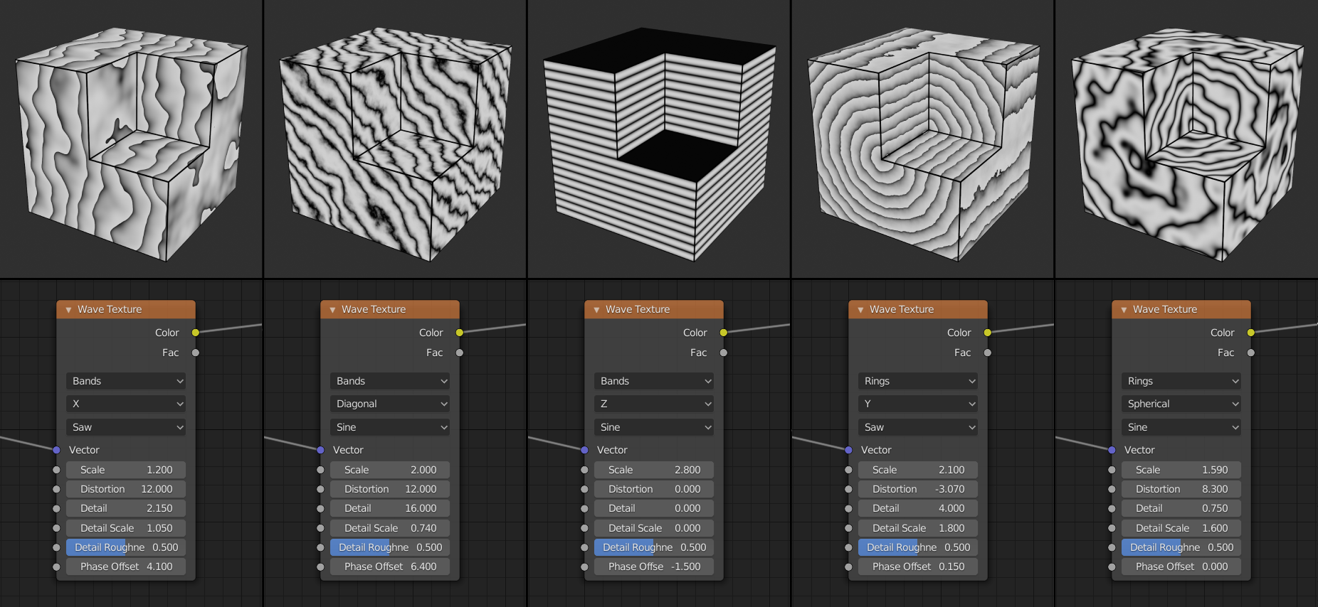

Exemples
../../../_images/render_shader-nodes_textures_wave_example.png
Textura d’ona.
