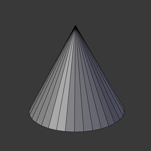

../../../_images/modeling_modifiers_generate_remesh_example-none.png
Unmodified mesh.
