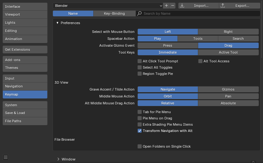

Keymap(キーマップ)
On this screen, you can configure keyboard and mouse shortcuts.
../../_images/editors_preferences_section_keymap.webp
Blenderの Preferences(プリファレンス) Keymap(キーマップ) セクション。
These preferences only apply to the Blender keymap.
Select with Mouse Button
Controls which mouse button is used to select items.
While left-click select is the default as it is consistent with most other software, right-click select has workflow advantages in certain scenarios.
Left(左):
LMB selects items while RMB opens the context menu.
Pros:
  • Familiar behavior for users coming from other applications.
  • Context menu access matches common industry standards.
  • Easier transition from other 3D and design software.
Cons:
  • Selection and transformation both use the primary mouse button, which can increase accidental movement when clicking near gizmos.
  • The 3D Cursor requires a modifier (e.g., Shift-RMB) to place.
Right(右):
RMB selects items while LMB places the 3D Cursor(3Dカーソル).
Pros:
  • Separates selection from transformation actions, reducing accidental edits during modeling.
  • Quick and direct 3D Cursor placement with LMB.
  • Historically optimized for precision modeling workflows.
Cons:
  • Less familiar to new users.
  • Context menu requires an alternate shortcut, depending on configuration.
Spacebar Action
Controls the action of Spacebar.
Play(再生):
Starts/stops animation playback. This option is good for animation or video editing work.
Tools(ツール):
アクティブなツールをすばやく変更できるように、カーソルの下にツールバーを開きます。このオプションは、モデリングやリギング作業が多い場合に適しています。
You can select tools in multiple ways:
  • Press Spacebar, then click a tool with the mouse.
  • Hold Spacebar, move the mouse to a tool, and release Spacebar.
  • Press Spacebar, then press the key that's shown in the popover (e.g. T for the Transform tool).
  • Press Spacebar and the tool's key together, e.g. Spacebar-T to select the Transform tool in one go.
Search(検索):
Opens up the Menu Search. This option is good for someone who is new to Blender and is unfamiliar with the menus and shortcuts. Even if you don't select this option, however, you can still access the search with F3.
If you select something other than Play, you can instead use Shift-Spacebar to start/stop playback.
Activate Gizmo Event
The activation event for gizmos that support drag motion. This option is only available when Select with Mouse Button is set to Left.
Press(押す):
The gizmo's operation gets initiated (and additional options become available in the Status Bar) the moment you press down the mouse button on the gizmo.
Drag(ドラッグ):
The operation only gets initiated once you start dragging the gizmo.
Tool Keys
Determines the behavior of tool activation keyboard shortcuts.
Immediate:
The tool is immediately in use. For example, if you press Ctrl-B while editing a mesh, this will immediately initiate a Bevel: you can move the mouse to change the size and then click LMB to confirm.
Active Tool(アクティブツール):
The tool is only selected (same behavior as if you were to click on it in the Toolbar). For example, if you press Ctrl-B while editing a mesh, the Bevel tool will be selected and the gizmo will become visible in the viewport; to actually perform a bevel, you then need to drag this gizmo.
Alt Click Tool Prompt
Tapping Alt shows a prompt in the status bar prompting a second keystroke to activate the tool. Note that this option is not available when using Emulate 3 Button Mouse.
Alt Tool Access
Hold Alt to use the Active Tool when the gizmo would normally be required. (For example, with the Move tool selected, you can hold Alt and drag the mouse anywhere in the viewport to move the selected object, rather than having to drag its gizmo.) This option is only available when Select with Mouse Button is set to Left and Emulate 3 Button Mouse is disabled.
Select All Toggles
Causes the Select All shortcut A to deselect all when any selection exists.
Region Toggle Pie
N opens a pie menu to toggle リージョン rather than always toggling the Sidebar region.
3D Viewport(3Dビューポート)
Grave Accent / Tilde Action
Navigate(ナビゲート):
Viewpoint pie menu, useful on systems without a numeric keypad.
Gizmos(ギズモ):
Transform gizmos pie menu, useful for quickly switching between transform gizmos. Note that this doesn't apply to tools that force a certain gizmo (Move, Rotate, Scale and Transform); if you have such a tool selected, the gizmo will stay the same no matter what you choose in the pie menu.
Middle Mouse Action
The action when MMB dragging in the viewport. This also applies to trackpads.
Orbit(周回):
Orbits the view around a central point. Shift-MMB is used for panning.
Pan(パン):
Pans the view. Shift-MMB is used for orbiting.
Alt Middle Mouse Drag Action
How to determine the new viewpoint when dragging Alt-MMB in the viewport.
Relative(相対):
The new viewpoint depends on both the mouse movement direction and the current viewpoint. For example, dragging the mouse horizontally rotates the viewpoint 90° around the view's current vertical axis.
Absolute(絶対):
The new viewpoint only depends on the mouse movement direction. For example, dragging the mouse to the right always puts the viewpoint on the positive side of the global X axis.
Tab for Pie Menu
By default, Tab toggles Edit Mode and Ctrl-Tab opens a pie menu for selecting from all modes. This option flips these two shortcuts around.
Pie Menu on Drag
When enabled, certain keys get different behavior when tapped and show a pie menu when holding them and dragging the mouse.
Tab
Tap:
Toggle Edit Mode.
Drag(ドラッグ):
Show Object Mode pie menu.
Z
Tap:
Toggle wireframe view.
Drag(ドラッグ):
Show Viewport Shading(3Dビューのシェーディング) pie menu.
AccentGrave
Tap:
Start first person Fly/Walk Navigation.
Drag(ドラッグ):
Show viewpoint pie menu.
Extra Shading Pie Menu Items
シェーディングメニューで表示される項目が追加されます (Z キー)。
Transform Navigation with Alt
Requires additionally holding Alt to navigate the view while transforming something. In return, you don't need to hold Alt to perform certain other operations.
As an example: if this option is disabled, dragging MMB always orbits the view, and when you're moving an object, you can drag with Alt-MMB to lock the movement to an axis. If this option is enabled, these shortcuts get inverted while moving: MMB does the axis lock, and you need to use Alt-MMB to orbit, Shift-Alt-MMB to pan, and Alt-Wheel to zoom.
This also applies to Proportional Editing(プロポーショナル編集) (where Wheel controls the size of the influence area) and Auto IK (where Wheel controls the length of the temporary IK chain). If the option is disabled, Wheel will zoom the view instead, and you need to use Alt-Wheel to change these properties.
