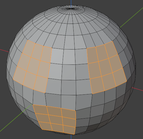

../../../../../_images/modeling_meshes_editing_mesh_transform_flatten_example-1.png
実施前。

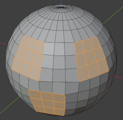

../../../../../_images/modeling_meshes_editing_mesh_transform_flatten_example-2.png
Flattened using Best Fit.
