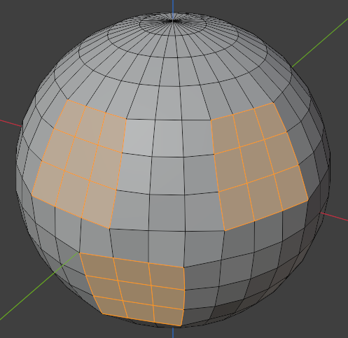

../../../../../_images/modeling_meshes_editing_mesh_transform_flatten_example-1.png
Trước.

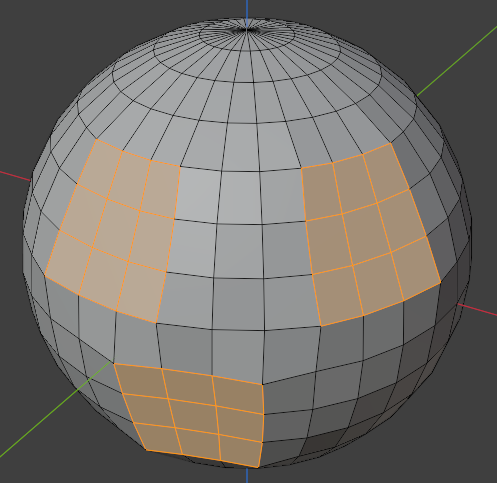

../../../../../_images/modeling_meshes_editing_mesh_transform_flatten_example-2.png
Flattened using Best Fit.
