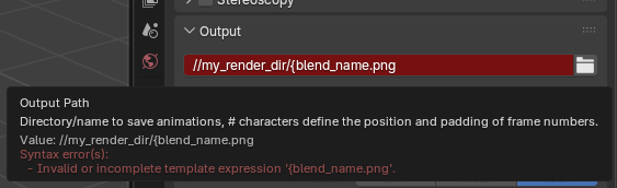

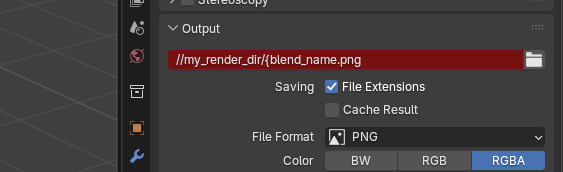

When there are template errors in a path, the path field will be highlighted red in the UI:
../_images/files_file_paths-invalid_path_template.png
Hovering over the path field will pop up a tooltip that contains a list of the template errors encountered in that path:
../_images/files_file_paths-invalid_path_template_tooltip.png
