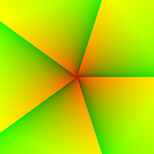

The Radial Tiling Node provides the ability to divide a 2D cartesian input coordinate system into as many radial segments as specified by the Sides input. Each segment has its own affinely transformed segment coordinate system, which can be used to tile textures in a radially symmetric manner.

- Coordenadas segmento
Segment coordinates for texture mapping within each radial segment.

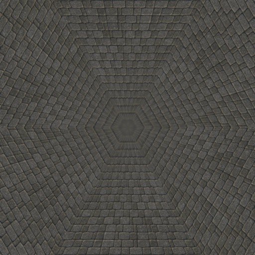

When working with textures that span the entire UV space there is usually the issue of visible seams along segment borders even if the original texture is seamless. The Normalize option eliminates these visible seams by ensuring that the X-coordinates always only cover the entire 0 to 1 range. This also introduces a distortion effect, which depending on whether or not it’s desirable may need to be mitigated using additional nodes.
