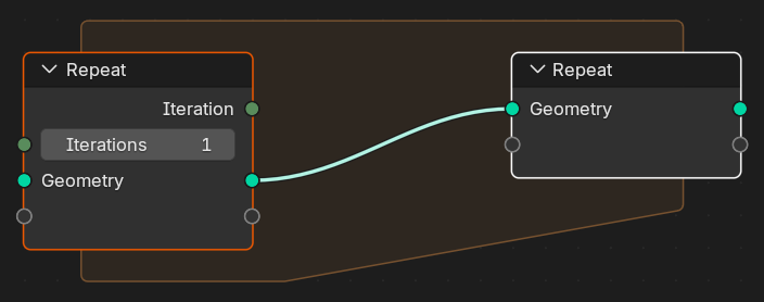

Zona de repetición
Una Zona de repetición ejecutará un conjunto de nodos una cierta cantidad de veces.
../../../_images/modeling_geometry-nodes_repeat-zone.png
The zone consists of an input node on the left, an output node on the right, and an orange area in the middle for placing the nodes to repeat. When the zone executes for the first time, it evaluates its inputs and forwards them to its inner nodes. These inner nodes can then write to the output node for providing inputs to the next iteration, and for providing the result of the zone after the last iteration.
The nodes inside the zone can also take inputs from nodes outside the zone – these inputs are then the same in every iteration. However, nodes inside the zone can’t send their outputs to nodes outside the zone.
