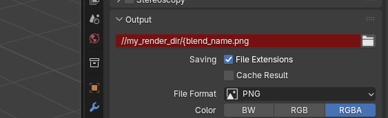

Errors
Paths that support templates can have template errors, which prevent the path from being processed.
For example, in the following path:
//my_render_dir/{blend_name.png
The expression {blend_name isn’t properly closed, which will result in an error.
When there are template errors in a path, the path field will be highlighted red in the UI:
../_images/files_file_paths-invalid_path_template.png

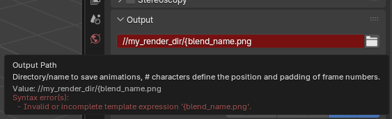

Hovering over the path field will pop up a tooltip that contains a list of the template errors encountered in that path:
../_images/files_file_paths-invalid_path_template_tooltip.png
