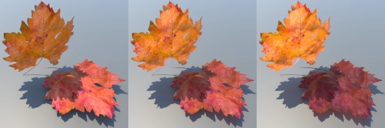

Thin Wall
Switch the surface to thin-walled mode. Useful for modeling thin structures, such as papers, leaves, and window sheets.
../../../_images/render_shader-nodes_shader_principled_thin_subsurface.webp
Subsurface Weight = 1, Anisotropy from -0.7 to 0.7
