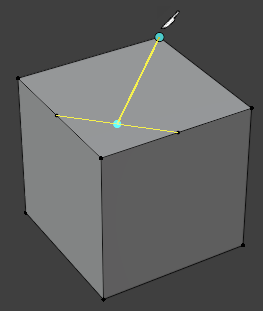

../../../../_images/modeling_meshes_tools_knife_line-active.png
Tall actiu de ganivet.
