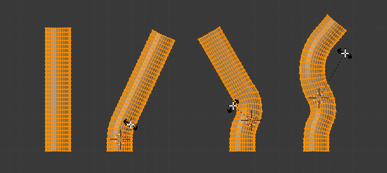

Exemple
../../../../../_images/modeling_meshes_editing_mesh_transform_bend_example-usage.png
Diversos girs consecutius.
