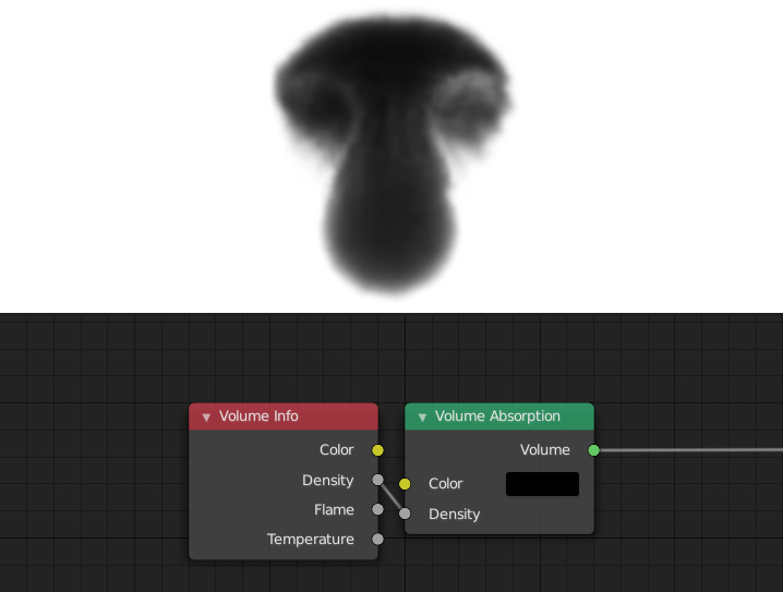

Exemple
../../../_images/render_shader-nodes_input_volume-info_example.jpg
Densitat de fum.
