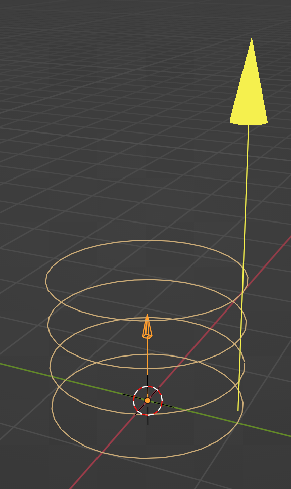

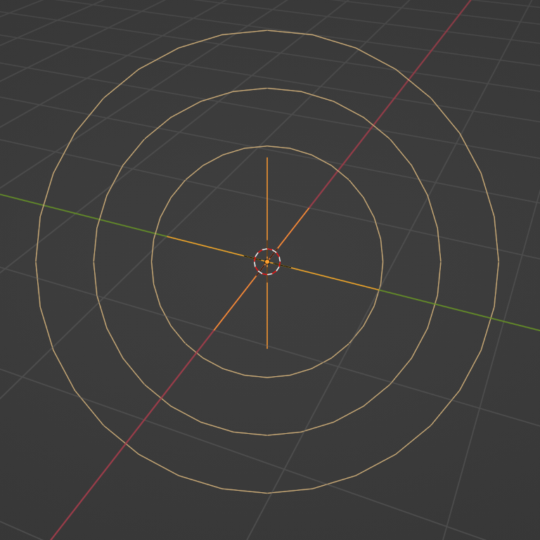

../../../_images/physics_forces_force-fields_types_vortex_visualzation.png
Vòrtex: camp de força.
../../../_images/physics_forces_force-fields_types_wind_visualzation.png
Vent: camp de força.
../../../_images/physics_forces_force-fields_types_force_visualzation.png
Força: camp de força.
