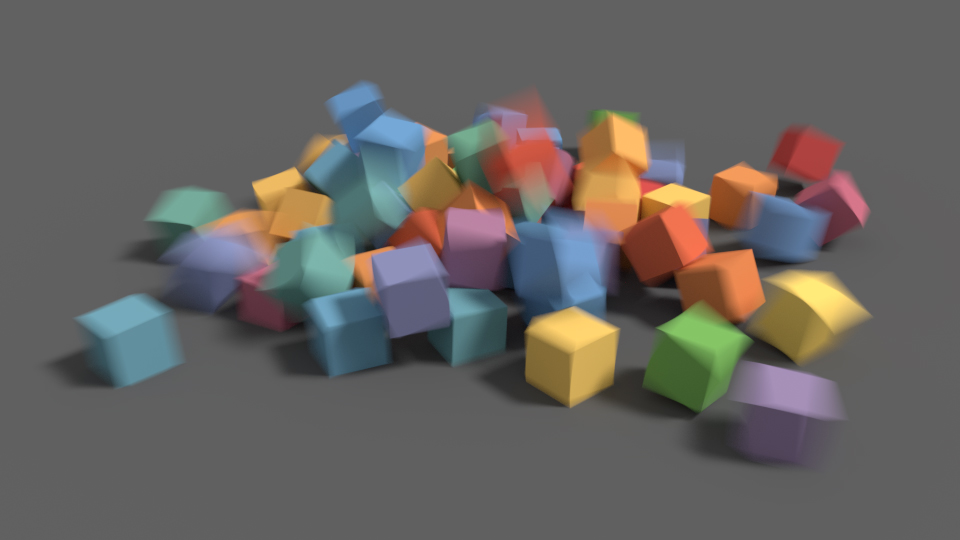

Exemple
../../../_images/render_shader-nodes_input_object-info_example.png
../../../_images/render_cycles_render-settings_motion-blur_example-cubes.jpg
Document blend d’exemple.
